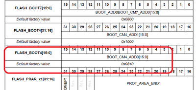

2024-12-03 12:46 AM - edited 2024-12-03 12:49 AM
@snnzdmr1 wrote:
I do not change the Option bytes. Default boot address(0x08100000 ). But still CM4 is not working.
Sorry, this is not the default option byte value for boot address and I think 'e' in 0x081E0000 came from your configuration:
From the RM. The factory value is 0x0810 while you have 0x081e.
2024-12-03 1:01 AM
