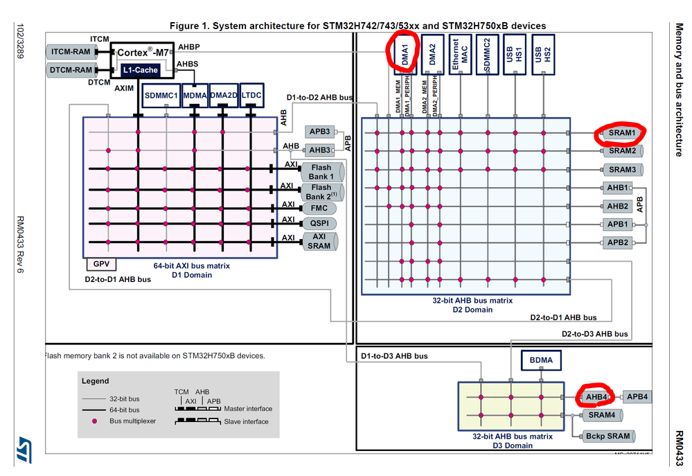

2021-11-26 8:51 AM
I see. So if want to reduce latency I need to put My memory buffer in SRAM4, and use BDMA instead of DMA1?

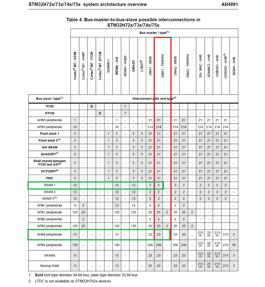

Before trying BDMA I want to make sure I got things right. Page 16 of AN4891 says one transfer in my case should take 25 cycles. 25 SYSCLK cycles? 23 AHB1 cycles + 2 AHB4 cycles? Either way DMA request rate should be lower than it is. 33.2*25 = 830 MHz...
2021-11-29 3:57 AM
I think you might be misreading that table. My reading of it is that e.g. Master Type DMA1 to slave Type APB4 Peripheral has Route=23 and you have to look at footnote 3 to see that Route 23 means 2 = via AHB bus matrix in D2 and 3 = via AHB bus matrix in D3
So it is in clock domains 2 and 3 via the AHB matrix. I guess it might take one clock cycle of the faster clock domain plus two cycles of the slower clock domain worst-case.
Not that it will take 23 cycles!
Regards, Danish

I see, my bad. You are saying, that
I guess it might take one clock cycle of the faster clock domain plus two cycles of the slower clock domain worst-case.But it still doesnt match my real value. Is there a document that help me find out exactly how many clock cycles it will take?
