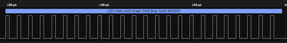

I feel like I am running out of options as to why this is occurring as the RM isn't that accurate to setup DMA + PWM using Timers.
The goal is to use TIM15 as a PWM generator running @ 800kHz running until 24 pulses are outputted and then stop until I command it to run again. Within these 24 pulses different duty cycle can occur from 64% for HIGH and 32% for LOW. This TIM15 is using the Repetition Counter register to indicate when 24 pulses as gone by.
What I have working thus far is a nice 24 pulse PWM stream but with only LOW (32%) present even though my buffer that gets transferred to CCR1 contains HIGH values (64%)

WS28128B_BUFF[23] uint32_t 0x5f (Hex) Picture of logic analyzer
Why arent I seeing my HIGHs ?

My guess: because the DMA is triggered after 24 pulses, not on every pulse, as a result of using repetition counter. Also, make sure that CCR1 is buffered.
Another problem: the buffer contains 32-bit data, but DMA is programmed for 16-bit words.
Honestly, there are at least two more efficient ways to output WS2812 data - using UART or SPI.

Hi! You were completely right as I misunderstood what repetition meant, quickly corrected that by returning that register to 0x00.
Corrected for the DMA already, good eye.
Sure, but i mean its easier to implement
