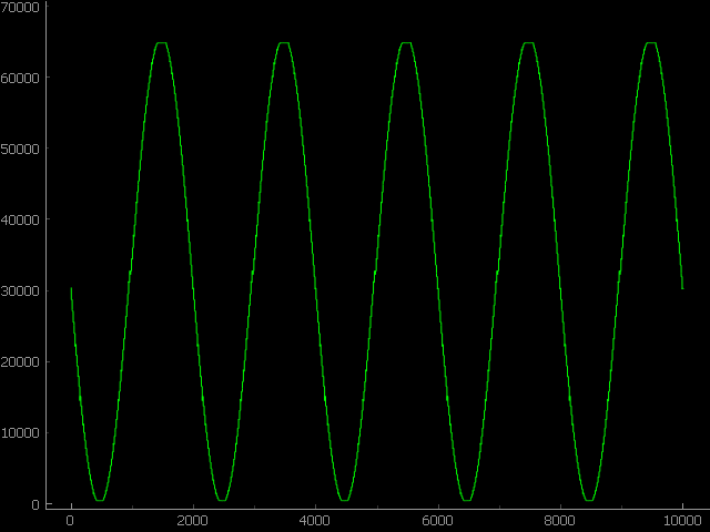

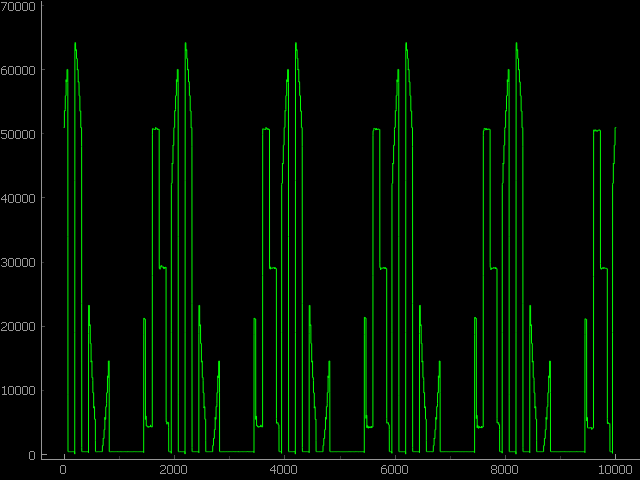

Hi @Community member :
I'm using onboard ADC and output to pc so that i can plot out the sinewave in python.
here is the graph with wave_LUT:
Here is the graph for calsine:
All the code exactly the same except one using lookup table and another is calculated.

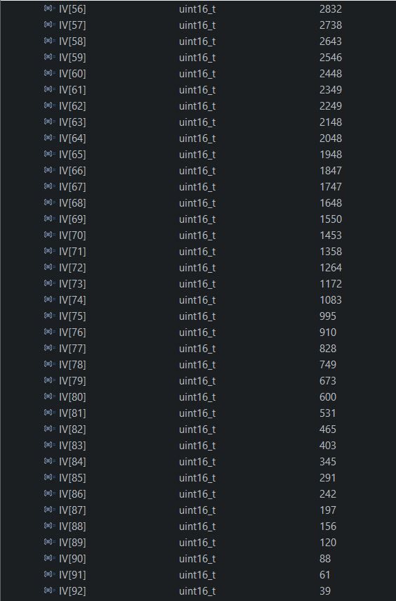

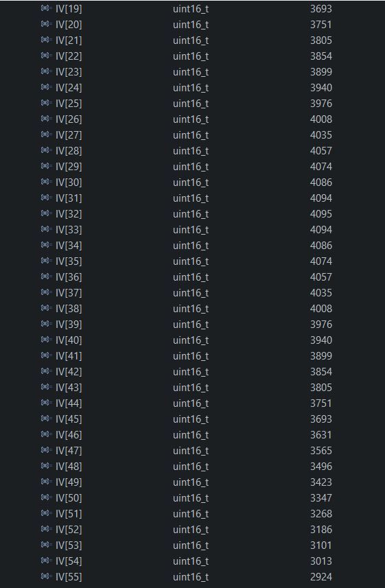

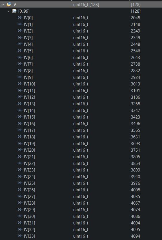

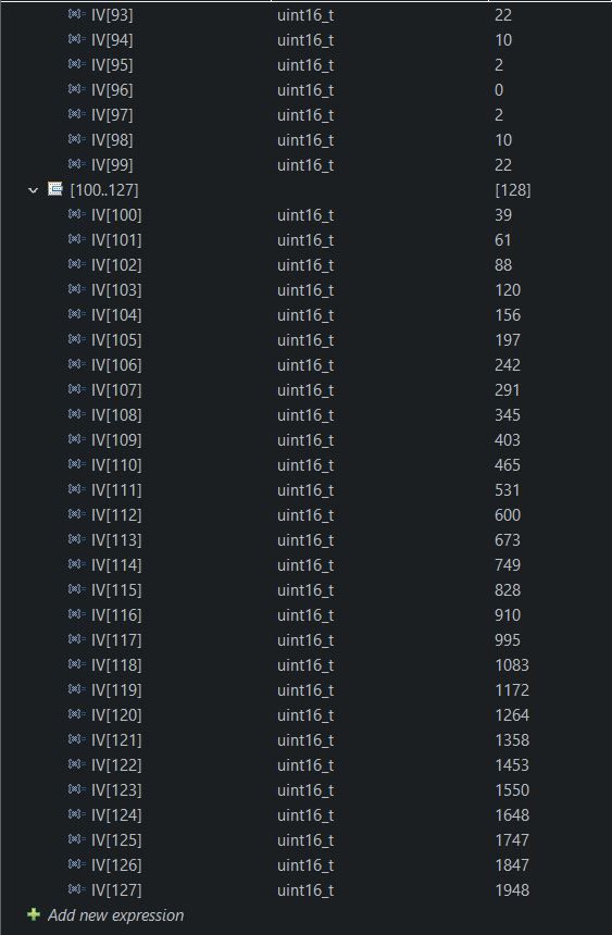

I check the IV value, they all looks normal to me.
except slight difference compare to the wave_lut table.
