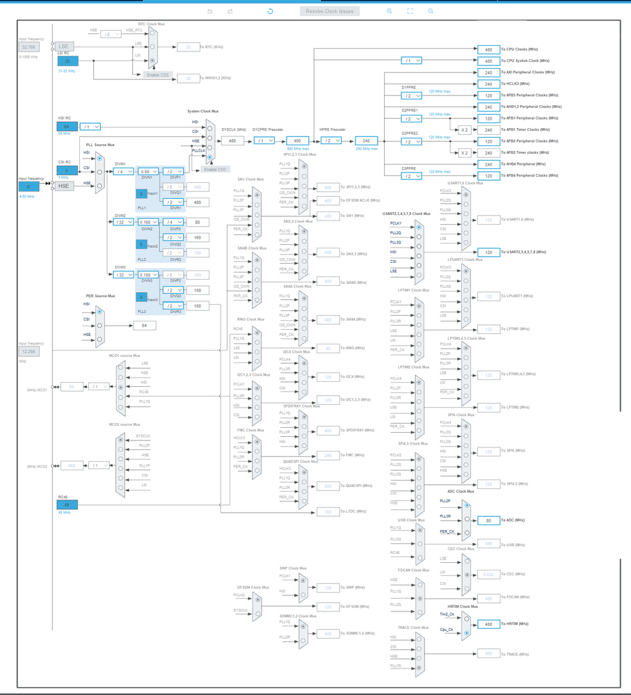

I programmed 480Mhz at the micro and 80Mhz at the ADC clock as can be seen here:

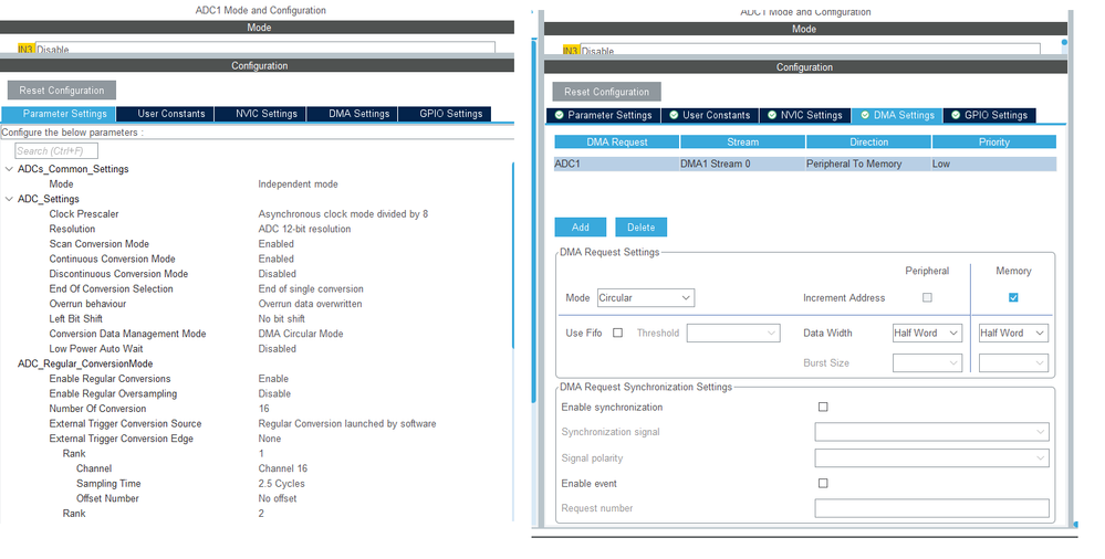

Also I programmed all ADCs in the same way. ADC prescaler was divided by 8 to have 10Mhz that is recommended for slow ADC channels, and the Rank1-N are set to 2.5 cycles to have 2.5+7.5=10cycles so have 1us/conversion as recommended:
