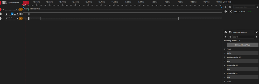

Here's some screenshots of the digital logic analyzer showing normal (but still unusual) behavior, and a lockup.
Regular Behavior:
Note that there is about 130us between the clock falling the first time and the actual clock pulses, then there's an unusually long pulse pulling SCL low ~600us after the transmission and holding low for ~7ms. That all seems strange.

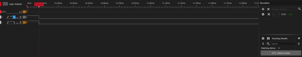

Lockup Behavior:
As you can see, both the clock and data lines are pulled low.
