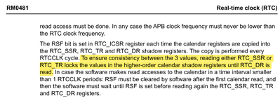

Call HAL_RTC_GetDate every time after you call HAL_RTC_GetTime. The time register is frozen until you read the date. This is intentional to keep time/date readings consistent.

With BYPSHAD=0 (which is default), you always have to read RTC->DR as the last register, after RTC->SSR and RTC->TR.
2025-03-28 7:01 AM - edited 2025-03-28 7:02 AM
