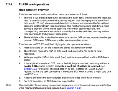

Dear @mahirmahota ,
You can look to our example here :
You need to configure the MPU region with right address of EDATA

Also, have a look on our Reference Manual on the way, we read these Areas : OTP, RO and High Cycle Data - EDATA.
Hope it is helping.
