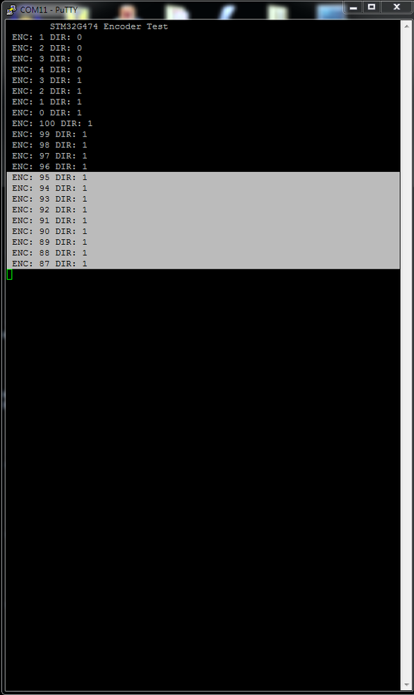

}On RST, I get the following results:
STM32G474 Encoder Test
ENC: 1 DIR: 0
ENC: 2 DIR: 0
ENC: 3 DIR: 0
ENC: 4 DIR: 0
When I turn the encoder CW, I get:
ENC: 3 DIR: 1
ENC: 2 DIR: 1
ENC: 1 DIR: 1
ENC: 0 DIR: 1
ENC: 100 DIR: 1
ENC: 99 DIR: 1
ENC: 98 DIR: 1
ENC: 97 DIR: 1
ENC: 96 DIR: 1
When I turn the encoder CCW, I get:
ENC: 95 DIR: 1
ENC: 94 DIR: 1
ENC: 93 DIR: 1
ENC: 92 DIR: 1
ENC: 91 DIR: 1
ENC: 90 DIR: 1
ENC: 89 DIR: 1
ENC: 88 DIR: 1
ENC: 87 DIR: 1
Attached screenshot:
Despite what I do, the direction, does not seem to change.
Any thoughts, suggestions what I am doing wrong in here ?
Thanks,
Manu
