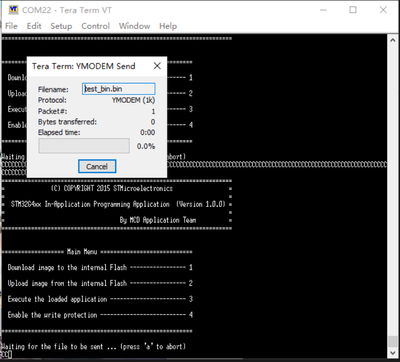

the issue I met is when I used Tera Term to transfer an APP bin file, the transfer stopped and the result is time_out as below
I am sure that the UART is OK because I can receive the menu strings and send 1 for choose download.

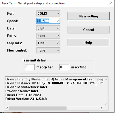

3. TT COM config as the AN4657 required, as below
send bin file as below

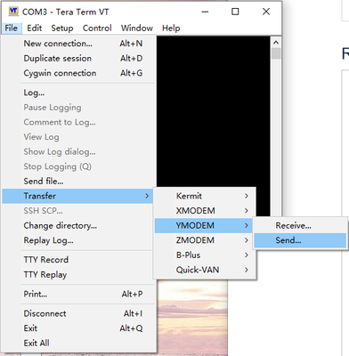

is something wrong?
if my TT config something wrong, how can I get the menu strings and I sent 1 for choosing download?
