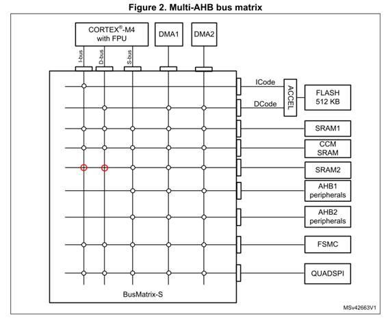

DS12589 Rev 1 (for G431) and DS12288 Rev 1 (for G474) both states in Section 3.5 that SRAM2 can be accessed by CM4 core through System Bus or through the I-Code/D-Code bus. However, Figure 2 "Multi-AHB bus matrix" suggests that SRAM is only accessible by CM4 core through System Bus.
2019-07-07 1:38 PM
That's most probably a copy/paste error, there's no indication that SRAM2 could be remapped to the I/D address space.

We will correct the figure in the coming release of datasheets :
The SRAM2 can be accessed by the CPU I-bus and D-bus after remap (like SRAM1). SRAM2 is supplied independently and can be retained in Standby mode.
Thanks for bringing this typo to our attention.

Hello Jan,
Sorry, after deep check, the original picture is correct and we will modify the description in the documents.
The SRAM2 is not accessible through I/D bus. The remap is possible only for SRAM1 / FMC / QUADSPI and the Flash.
