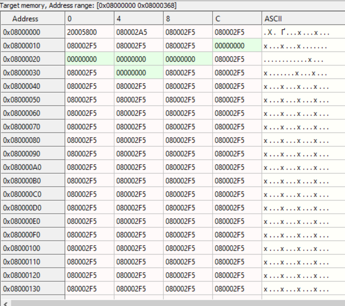

2020-04-27 1:05 AM
Disassembly shows some weird stuff in the beginning.
2020-04-27 1:14 AM
Yeah, that would be the vector table, a list of addresses, and not executable code you can disassemble.
Odd the FLASH basis isn't 0x08000000, but not my part.
Make sure your design pulls BOOT0 low.
