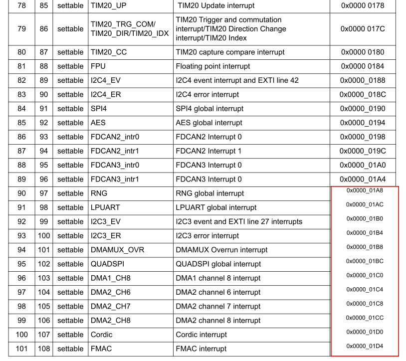

I think I found a possible error in the STMG4 reference manual RM0440 Rev 4, in Table 97 of section 14.3: in the IVT address column, the addresses from 0x0000_0198 to 0x0000_01A4 appear two times, instead of continuously increasing (entries 86 to 93). This is a problem as the last address of the IVT and it's size don't match. Could somebody please confirm that this is indeed an error in the RM?

Hi @TOrla.1 ,
You are right. After check, the address numbers should be recalculated with increment 4:
This is reported internally for correction.
Thank you for your contribution.
Best Regards,
Imen

Hello @TOrla.1 ,
Thank you for bringing this to our attention.
I raised it internally for check and fix.
Best Regards,
Imen

Hi @TOrla.1 ,
Best Regards,
