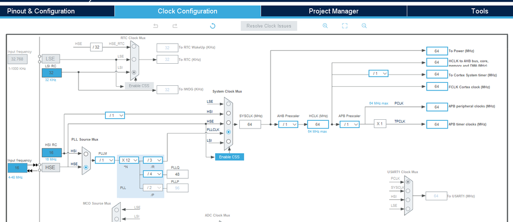

Which clock is selected for host configuration? Could you share your software setup? your hardware configuraiton?

Hi @Kimjunho
2024-03-06 1:34 AM
The USB clock is 48 MHz with an external crystal oscillator of 16 MHz.
It is recognized only once when the initial power is turned on, and the USB interrupter does not operate from then on.
