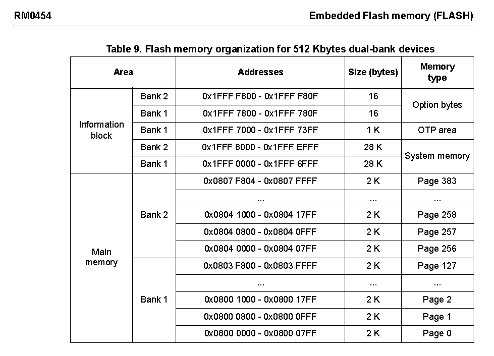

I work on STM32G0B0. This picture is correct from reference manual?
For BANK1 appears to be correct, but for BANK2, numbering starts from 256 to 383 which I guess id wrong. Shall be 128...255.
Asking because also FLAHSH->CR, PNB appears to be wrong too.
Can some ST employee clarify this?
Thanks!

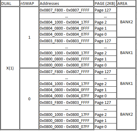

2023-05-11 5:57 AM - edited 2023-11-20 5:55 AM
Dear @yo3hcv,
This table below reflects how page number works on G0 dual/single bank capability as it depends of nSWAP_BANK option bit.
Following this table, make sure your software is aligned. Here below an example to erase a page located into the Bank2, two points are mandatory:

2023-05-10 12:09 AM
Hi @yo3hcv ,
Yes we have noticed this issue on the documentation both banks are in series, so for the 512K :
BANK1 : page 0 to 127
BANK2 : page 128 to 256
This should be fixed on the new version of the reference manual.
Thanks again for you contribution ;).

2023-05-12 11:40 PM
Hello Gwénolé,
Not quite accurate, nSWAP has nothing to do with layout, however, your pages numbering are correct.

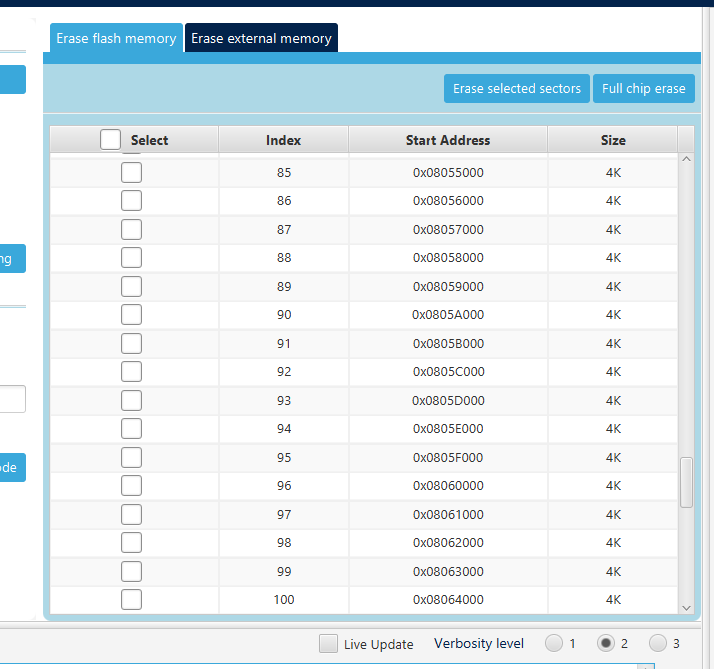

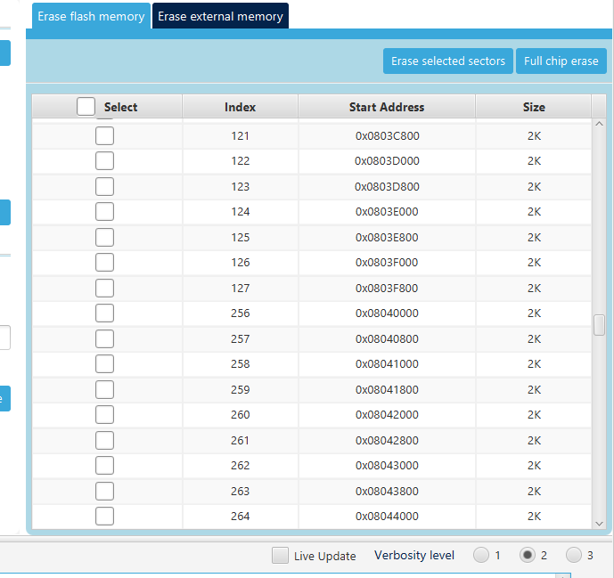

2023-05-12 11:50 PM - edited 2023-11-20 5:56 AM
Also please fix the STCube Programmer too
If you de-select DUAL_BANK will show 4k sectors which is wrong
For DUAL_BANK will show correct 2k sectors, but with the same crap numbering, jumping to 256 ???
