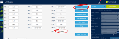

If you don't have source code, you can use STM32CubeProgrammer to run and see where the PC gets stuck, although without the program context this is harder to debug. It should at least convince you that the chip is trying to do something.
