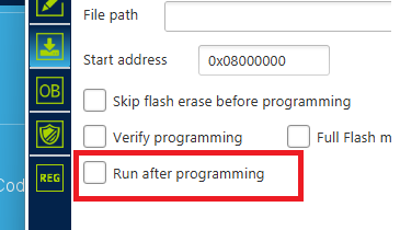

Did you check the option "Run after programming"?:
