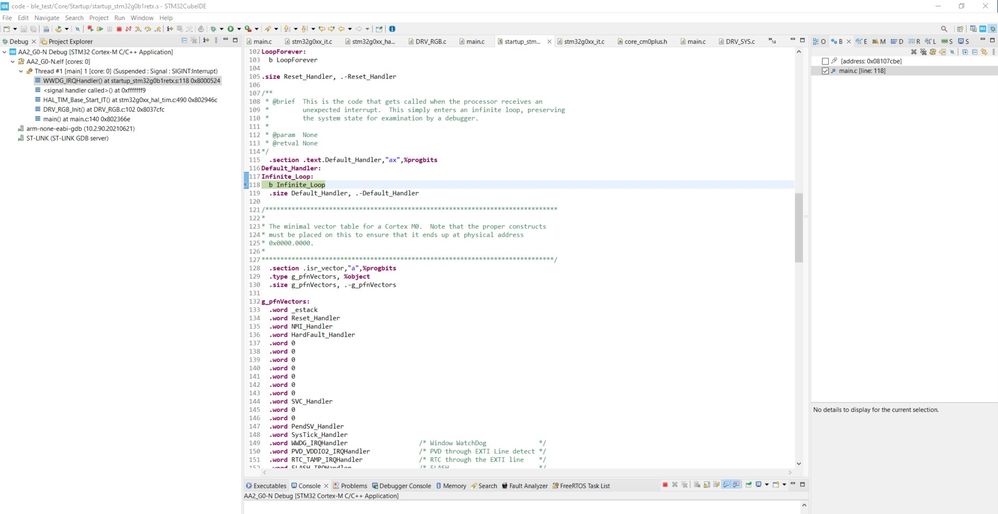

2023-02-26 11:28 PM
Looks like it's debugged already - see the called procedures' hierarchy in the left pane - watchdog interrupt is firing.
2023-02-26 11:39 PM
watchdog hasn't been configured in the code. It is the default handler who is triggering the watchdog handler. Not sure why?
