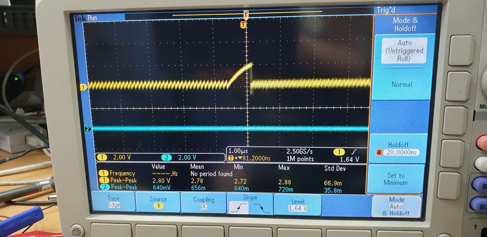

When observing the waveform with an oscilloscope, the address and other control signals were observed with normal waveforms.
However, the signal on the data bus looks like a triangle.
I want to know what the problem is.

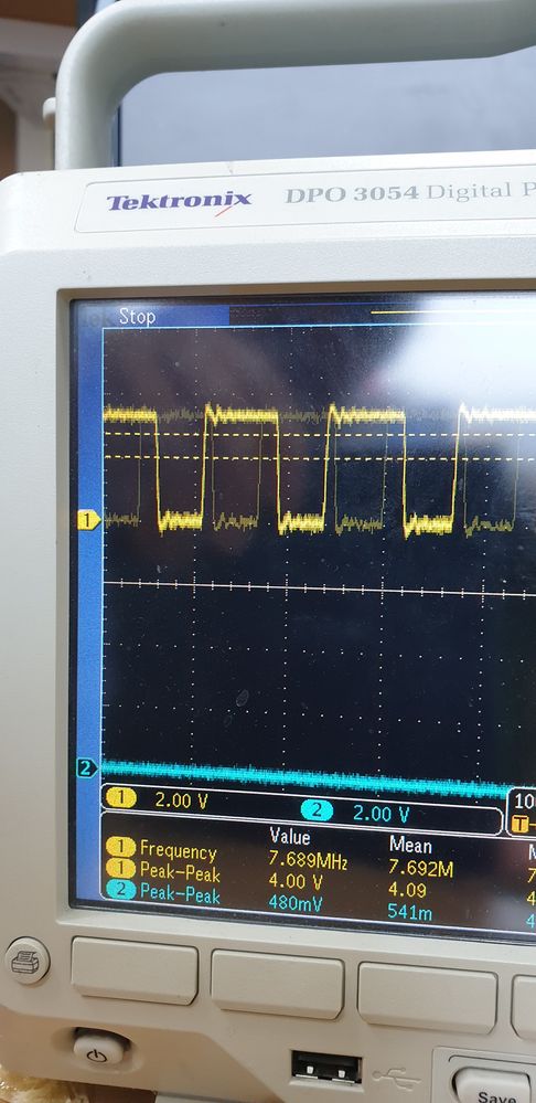

EVAL-B / D shows a square wave when I watch a waveform, but my board has a triangular waveform, not a square wave.
The voltage should be 3.3V but it is about 0.8V.
Control signals...
but Data bus signal is...
The above figure shows that 1 is written on the data bus and reading is repeated.
As you can see in the picture,
In EVAl, a square wave came out, but on my board, it came out like a triangle wave.
The clock frequency or other signal is normal, but it seems that the data bus is not initialized due to these signals.
Can you see what's wrong?
