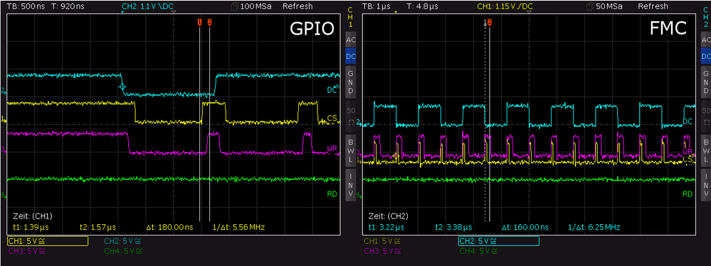

So i activate the FMC, but the Timings do not fit to the Needs of the SSD1963. The CS should rise before WR/RD and D/C like during GPIO mode. But as you can see CS rises at the same time as WR and D/C .

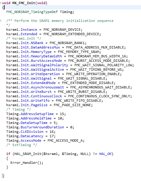

These are the Settings for FMC. How can I adjust the Timings to get a waveform with an early CS ? Can it be done just with Software or do i Need external Hardware ? Checked several documents (DM00166116 page 172, STM32F746 datasheet, AN2784, AN2790), but did not get a clue.

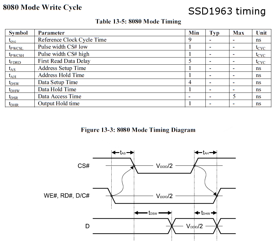

verfied my FMC Settings with my oscilloscope, so I noticed that there is almost no delay between
CS, WR and DC no matter which FMC Settings i tried. And the 0.5ns is a jitter which occur to all
signals , not a promised Timing value.
The SSD1963 Needs a delay of at least 1ns - tAH.
