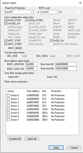

The details are as follows:
1. The BOOT0 pin is pulled down.
2. Setting of Boot option byte (using ST-Link Utility)
3. Memory definition in FLASH.Id
And then I configured the GPIO in CubeMX as OUTPUT and attempted periodic GPIO toggling code, but LEDs does't work at all.

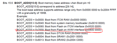

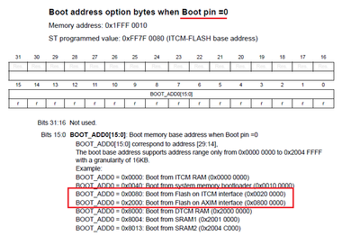

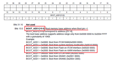

Are you intentinnaly pulled up BOOT pin to VDD?
If yes refer to the RM:
If you need to boot from Flash AXI BOOT_ADD1 needs to be set to 0x0080, if from Flash-ITCM you need to set BOOT_ADD1 to 0x2000.
Otherwise you need to pull down BOOT pin to GND and the configuration is as following:
