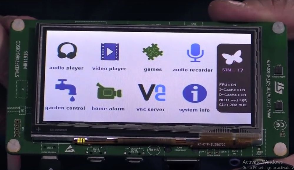

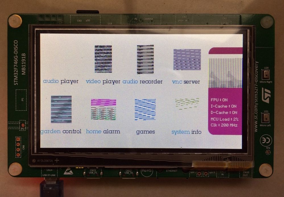

Dear All.
I try to complier sample code from st at D:\STM32\STM32F746NG\
STM32Cube_FW_F7_V1.7.0\Projects\STM32746G-Discovery\Demonstration\
MDK-ARMOn sample video from
https://www.youtube.com/watch?v=R78zvO-s6H0
quality is good.but on complier and run sample code. quality not same. maybe need to modify some setting in coding.
Have someone can help me to fix this issue.
Thank you.

Isn't the binary of the original demo present somewhere in that package? If yes, try to upload that one, to exclude hardware problem.
2017-08-22 1:59 AM
The graphical elements are missing from the QSPI memory in your case.
The easier way to upload them is to use
and to enable the QSPI external loader (external loader menu -> N25Q128A_STM32F746G-DISCO)Follow the instructions from the readme file in the root of the demo project

________________ Attachments : pastedImage.png : https://st--c.eu10.content.force.com/sfc/dist/version/download/?oid=00Db0000000YtG6&ids=0680X000006HyOK&d=%2Fa%2F0X0000000b8T%2FUL.r_UCGc_JgjB64pULegGBmkkz7uPYfYTHkl0PG8lk&asPdf=false2017-08-23 9:41 PM
This HEX file also contains the data for the QSPI memory.
This is exactly what you are missing right now.
In order to program it, you must enable the flash loader so STLink utility can program it.
Keil (or any other toolchain...) cannot do that.
Once it is programmed you can use your own compiled version: You can modify it and debug as you like.

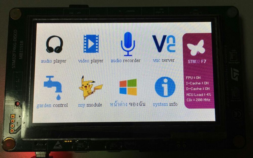

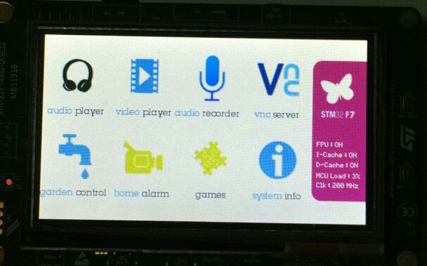

After try
Right now. Pic display correct.
and I try to test modify some icon and change to thailand language
Thank you for help
