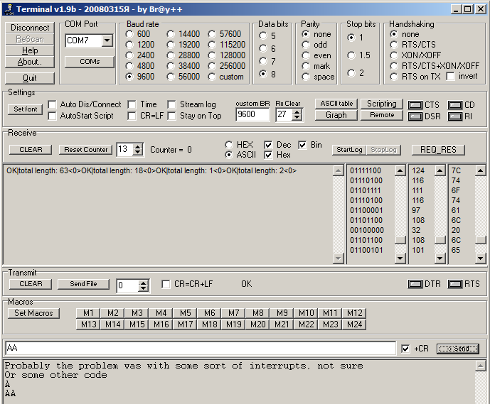

Transmission works, reception does not work.
Defining interruptions is required to getthings better. One should define also this codein stm32f7xx_it.c :
void UART7_IRQHandler(void) {
//p1045 clear registers!
UART7->ICR |= USART_ICR_ORECF;
UART7->RQR |= USART_RQR_RXFRQ;
2017-07-05 2:09 AM
Interrupt handler is being called twice more than the actual number of recieved bytes. Here's edit to make it called exact times:
if ((UART7->ISR & USART_ISR_RXNE )!=0) {
//read the data, check it
uint8_t UART_data = UART7->RDR;
globalCounter++;
2017-07-05 8:45 AM
Do not enable and process interrupts on transmission, like
UART7->CR1 |= USART_CR1_TXEIE
or
TCEIE
It is useless (and leads to bad things)
