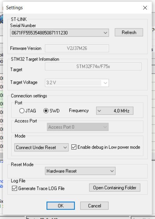

2018-12-19 5:38 PM
SEGGER have implemented a workaround for this hardware core bug in their J-Link debuggers. On-board ST-LINK can be converted to J-Link OB.
https://www.segger.com/products/debug-probes/j-link/models/other-j-links/st-link-on-board/
2020-10-15 5:59 PM

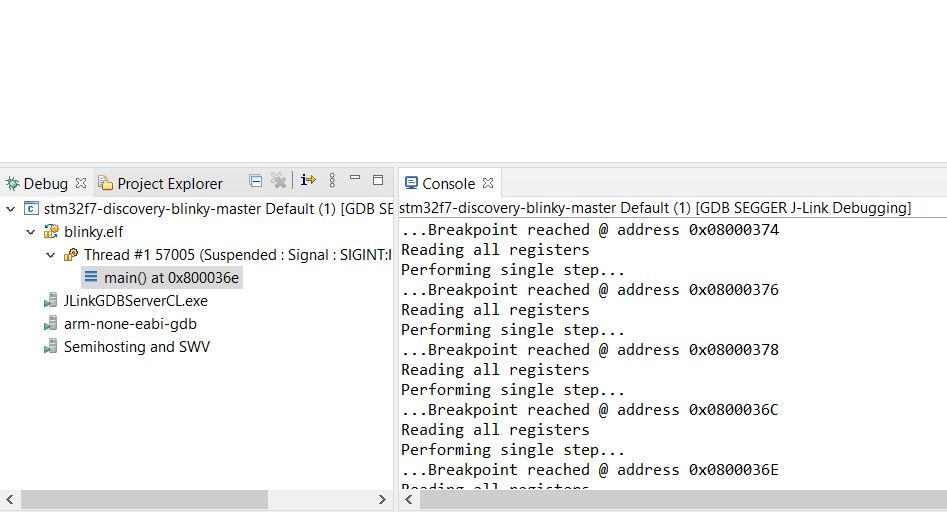

It does not work in Segger J-Link OB either...Seems once again ST Sold a $70 dollar board without single stepping ability so shifting blame to Segger is a poor implementation of a joke without re-spinning the Silicone...It only works by using the ST Link Utiliy in a special tweaked mode...Open OCD does not work using ST Link or upgrading to Segger. It cannot step as specified above...Single Stepping fails completely in Segger J-Link OB by jumping steps because it cannot stop on a breakpoint and runs hay-wire...Same deal with ST-Link...Sad as it looked like a promising board! Unfortunately it is Junk in any debug mode and I have tried them all...
