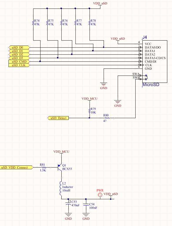

I've Designed SD Circuit from ST example Boards. only difference is a transistor for selecting the power of sd card. it means i should RESET a GPIO to connect sd power. i will attach the circuit.
every yellow ports in the figure, is connected to MCU directly.

it worked. there is a problem in hardware level. I omitted the transistor(BCX53) and connected VDD_MCU to VDD_uSD directly. everthink is OK.In fact the transistor has decreased voltage level. so VDD was lower than Vdd High.
