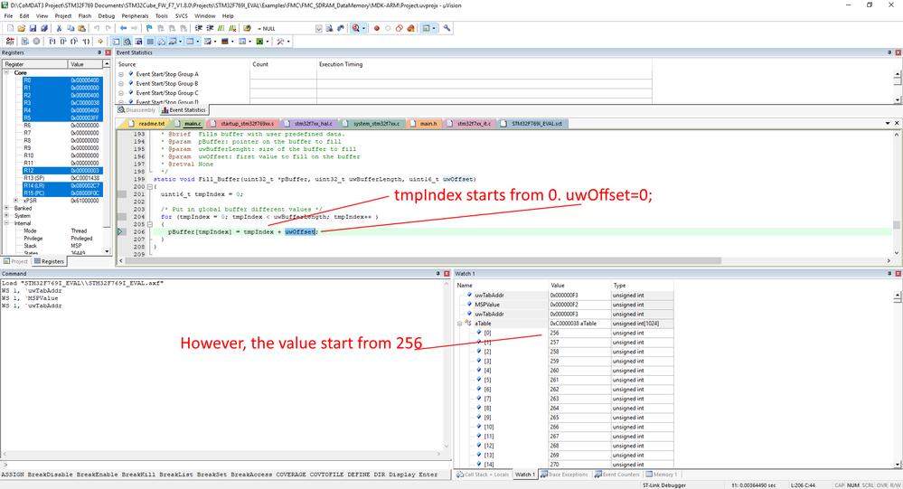

I tested FMC_SDRAM_DataMemory Example of STM32F769I_EVAL.
I found out that the data written to SDRAM is not correct.
See below picture for your checking. I believe HAL and FMC driver in system_stm32f7xx.c is not correct. Please advise me how to make it correct. Thanks.

I'd probably have the "Memory 1" window dump 0xC0000000 as 32-bit unsigned words. If everything has bit 8 set, I would look at the schematic critically and make sure no other use for D8 is specified or jumpered on the board.

Dear Clive,
Do you mean PD8?
In the example, SDRAM is initialized in system_stm32f7xx.c.
How can I modify it?
Thank.
