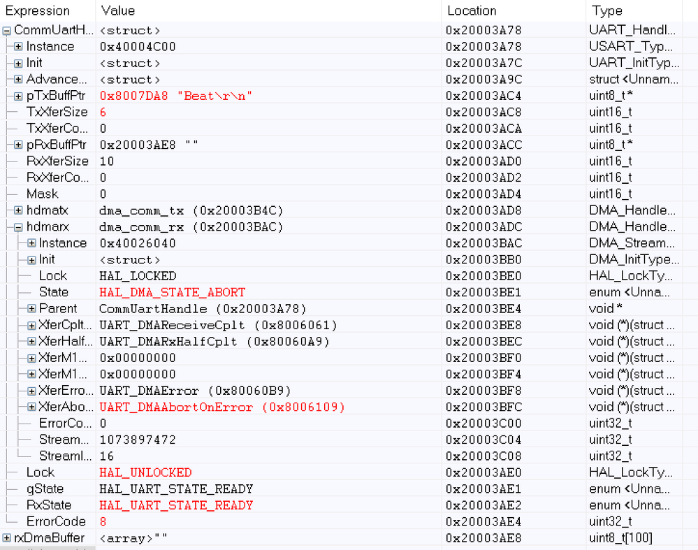

2019-07-30 7:51 AM
JW the Registers are below in text and screenshot from IAR as well as attached in a log file. These values are captured when the DMA1_Stream2_IRQHandler fires after a transmission of 5 bytes. Please note the UART shows Error 8 (0verrun) in this scenario, not sure why that is.
Thanks!
Expression Value Location Type
CommUartHandle <struct> 0x20003A78 UART_HandleTypeDef
Instance 0x40004C00 0x20003A78 USART_TypeDef *
Init <struct> 0x20003A7C UART_InitTypeDef
AdvancedInit <struct> 0x20003A9C struct <Unnamed 23>
pTxBuffPtr 0x8007DA8 "Beat\r\n" 0x20003AC4 uint8_t *
TxXferSize 6 0x20003AC8 uint16_t
TxXferCount 0 0x20003ACA uint16_t
pRxBuffPtr 0x20003AE8 "" 0x20003ACC uint8_t *
RxXferSize 10 0x20003AD0 uint16_t
RxXferCount 0 0x20003AD2 uint16_t
Mask 0 0x20003AD4 uint16_t
hdmatx dma_comm_tx (0x20003B4C) 0x20003AD8 DMA_HandleTypeDef *
hdmarx dma_comm_rx (0x20003BAC) 0x20003ADC DMA_HandleTypeDef *
Instance 0x40026040 0x20003BAC DMA_Stream_TypeDef *
Init <struct> 0x20003BB0 DMA_InitTypeDef
Lock HAL_LOCKED 0x20003BE0 HAL_LockTypeDef
State HAL_DMA_STATE_ABORT 0x20003BE1 enum <Unnamed 16>
Parent CommUartHandle (0x20003A78) 0x20003BE4 void *
XferCpltCallback UART_DMAReceiveCplt (0x8006061) 0x20003BE8 void (*)(struct __DMA_HandleTypeDef *)
XferHalfCpltCallback UART_DMARxHalfCplt (0x80060A9) 0x20003BEC void (*)(struct __DMA_HandleTypeDef *)
XferM1CpltCallback 0x00000000 0x20003BF0 void (*)(struct __DMA_HandleTypeDef *)
XferM1HalfCpltCallback 0x00000000 0x20003BF4 void (*)(struct __DMA_HandleTypeDef *)
XferErrorCallback UART_DMAError (0x80060B9) 0x20003BF8 void (*)(struct __DMA_HandleTypeDef *)
XferAbortCallback UART_DMAAbortOnError (0x8006109) 0x20003BFC void (*)(struct __DMA_HandleTypeDef *)
ErrorCode 0 0x20003C00 uint32_t
StreamBaseAddress 1073897472 0x20003C04 uint32_t
StreamIndex 16 0x20003C08 uint32_t
Lock HAL_UNLOCKED 0x20003AE0 HAL_LockTypeDef
gState HAL_UART_STATE_READY 0x20003AE1 enum <Unnamed 17>
RxState HAL_UART_STATE_READY 0x20003AE2 enum <Unnamed 17>
ErrorCode 8 0x20003AE4 uint32_t
rxDmaBuffer <array>"" 0x20003AE8 uint8_t[100]
2019-07-30 8:22 AM
I mean the hardware registers of UART and DMA, not HAL/Cube's intestinal content.
2019-07-30 8:30 AM
DMA1_Stream2 (Channel 4) is UART4_RX, so it's certainly not the consequence of *transmitting* bytes.
STM32Cube_FW_F7_V1.7.0\Drivers\STM32F7xx_HAL_Driver\Inc\stm32f7xx_hal_usart.h:
#define HAL_USART_ERROR_ORE ((uint32_t)0x00000008U) /*!< Overrun error */
Overrun may be consequence of bytes arriving at UART while not being picked by a stuck DMA.
Observing the relevant DMA registers (i.e. the givern stream's registers plus the status registers) should shed more light on the problem.

2019-07-30 8:53 AM
JW - sorry for the confusing wording - I meant transmitting 5 bytes to the device, not from the device. Using a USB-UART cable to send data to remove any uncertainty.
