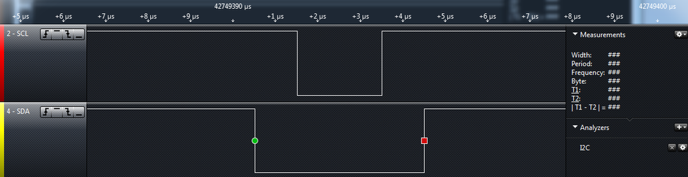

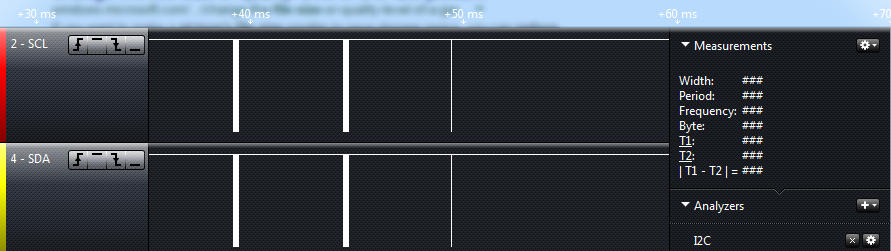

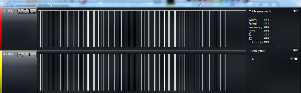

I'm attempting to talk to two devices, a barometer (MS5611) and a magnetometer (HMC5883L), using I2C with DMA on an STM32F4. The barometer runs on a timer (10ms), while the magnetometer runs through an interrupt line.The slaves work well together, communicating only when the other isn't as verified by a logic analyzer. However, occasionally (~ every 20 secs), when the MCU attempts to write to the barometer the start condition is immediately followed by a stop condition. No address is sent, it is a void message! I have attached pictures below.I2C working nicely until the last part:2014-10-17 2:07 AM

Sorry no answer here, but I am having EXACTLY the same problem, interfacing an STM32F437 to an i2c crystal oscillator. In my case the XO is the only slave device on the i2c bus, and I can read and write successfully between 2000 - 10000 times and then, bam, everything stops. On the software side the failure is occurring inI2C_WaitOnMasterAddressFlagUntilTimeout when called from I2C_MasterRequestWrite.
The slave address is written tohi2c->Instance->DR but it never appears on the bus, and theI2C_FLAG_ADDR flag is never set. Instead of the address appearing on the bus, a STOP is generated (logic probe attached).
I would also be incredibly grateful if anyone has any insight into what could be causing this. Thanks, Kieran. ________________ Attachments : i2c_fail.png : https://st--c.eu10.content.force.com/sfc/dist/version/download/?oid=00Db0000000YtG6&ids=0680X000006I0eJ&d=%2Fa%2F0X0000000biv%2FqGAFmEteR8WK4bkpl7nd_Q5Ma6_1IL_2MvAoOaeJLaw&asPdf=false2014-10-27 4:27 AM
