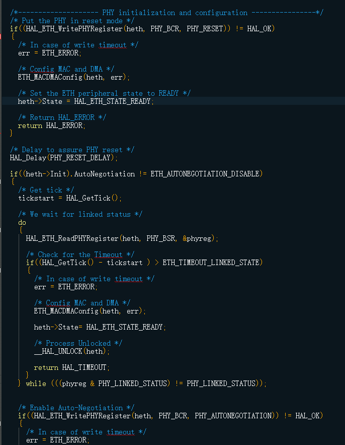

My hardware is F429 + LAN8720A, firmware is STM32Cube_FW_F4_V1.16.0
when power up, everything is ok, PHY_BCR = 0x3100, phy link up, at this time I just reset f429,
PHY_B
C
R = 0x2100, PHY link failed, and the two leds are off.Here are some codes in the HAL driver:
My question is after reset we should set the BCR, but the HAL driver reset the BCR, then just wait link up, is that right?
2017-08-08 12:57 AM
F429 reset pin and LAN8720A reset pin use the same reset signal. I use the HAL_NVIC_SystemReset() to soft reset F429.
Now I add HAL_ETH_WritePHYRegister(heth, PHY_BCR, PHY_AUTONEGOTIATION) after HAL_Delay(PHY_RESET_DELAY);
