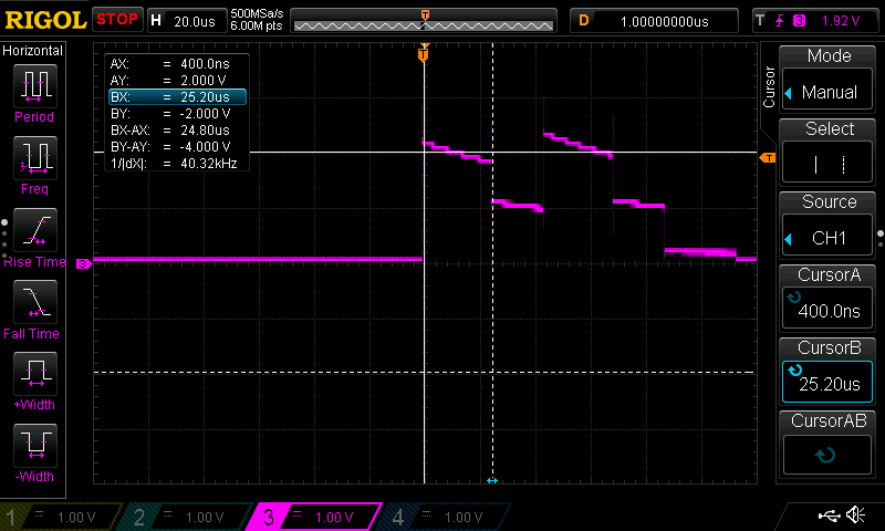

What exactly do you mean by 'data pulse' and how did you measure it?

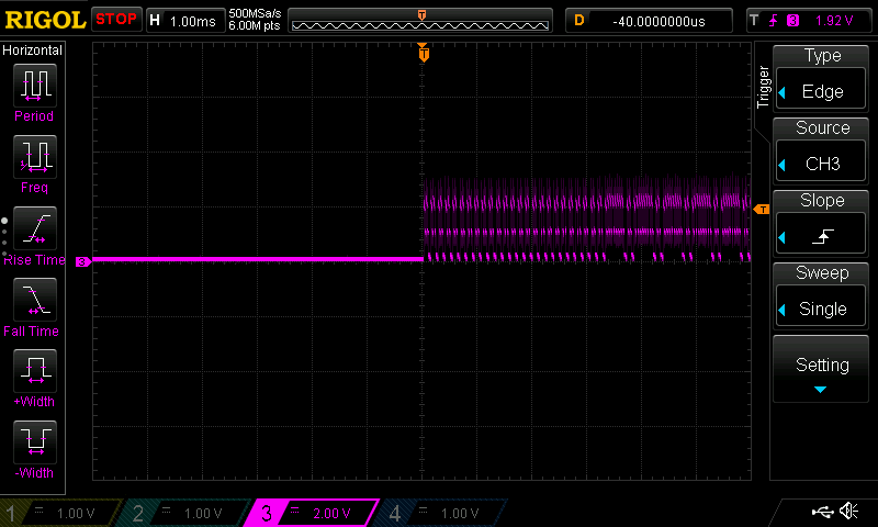

Correct, I enabled MC01 and MC02 and went through each of the clocks.
Here is a screen cap of the Oscilloscope measuring one of the data lines. Here the code is set to write 0xFFFF without delays in an infinite loop.

I posted screen captures of the oscilloscope measuring the data pin above to show what I meant.This panel does not provide the necessary sync and clock pins for the RGB interface.
