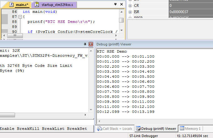

This works for me in Keil,
// STM32F4-Discovery RTC HSE Demo (Keil) - sourcer32@gmail.com

2014-03-31 7:41 PM
