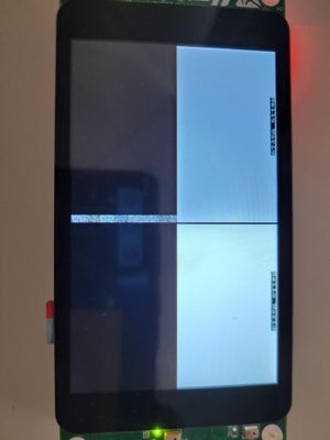

I'm currently trying to program an STM32F469I-Discovery REV-B-01. I'm using the BSP files from STM32Cube_FW_F4_V1.28.0.
What I want: Just a white screen with "Hello World" at the top.
What I'm facing: Look at the picture.

Hello @DerFreaker ,
May be this example provided in the STM32CubeF4 firmware package help you: STM32Cube_FW_F4_V1.28.0\Projects\STM32469I-Discovery\Applications\STemWin
Please check the application note AN4323 for detailed steps on using the STemWin library.
