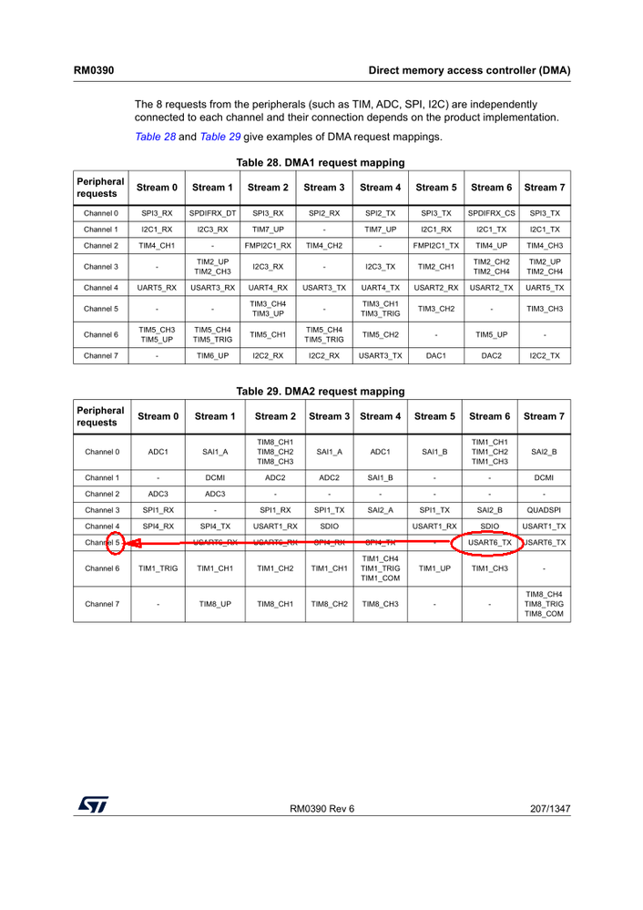

> DMA2_Stream6->CR = DMA_SxCR_CHSEL_2 | DMA_SxCR_MINC | DMA_SxCR_DIR_0 |
DMA_SxCR_TCIE | DMA_SxCR_EN;
0693W00000LvlEwQAJ.pngJW

DMA2_Stream6->CR =
DMA_SxCR_CHSEL_0 | DMA_SxCR_CHSEL_2 | // channel 5
DMA_SxCR_MINC | DMA_SxCR_DIR_0 | // memory-to-peripheral, increment memory addr
DMA_SxCR_TCIE | DMA_SxCR_EN; // enable channel & complete interrupt
Got it now thx
