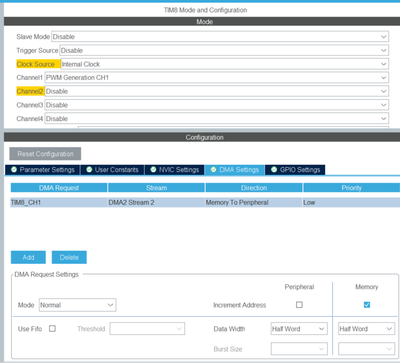

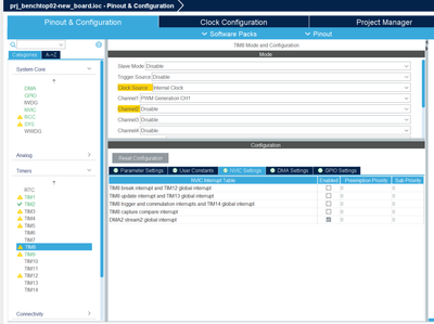

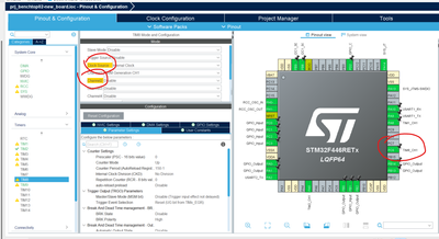

Hi, I am trying to implement PWM generation on PC06 from TIM8. The cubeMX is showing following warnings and not generating the clock on desired PIC_PC06??
RGB LED is Adafruit NEO Pixel 7 https://www.adafruit.com/product/2226
See the attached images and please advise for a solution ASAP. Thanks
Clock frequency 120MHz
APB2 timer #8 clock 120MHz
LED clock 800KHz, timer#8 period = 150
Internal clock warning: Clock source conflict with PA0-WKUP mapped with GPIO output.
I can't change PA0 as it is on custom board.

Yellow warning do not indicate errors. They simply note that you cannot assign additional functions since the pins are already in use. It is not the most user friendly solution, but.
There is nothing to correct or fix here, as least not in the screenshots.
