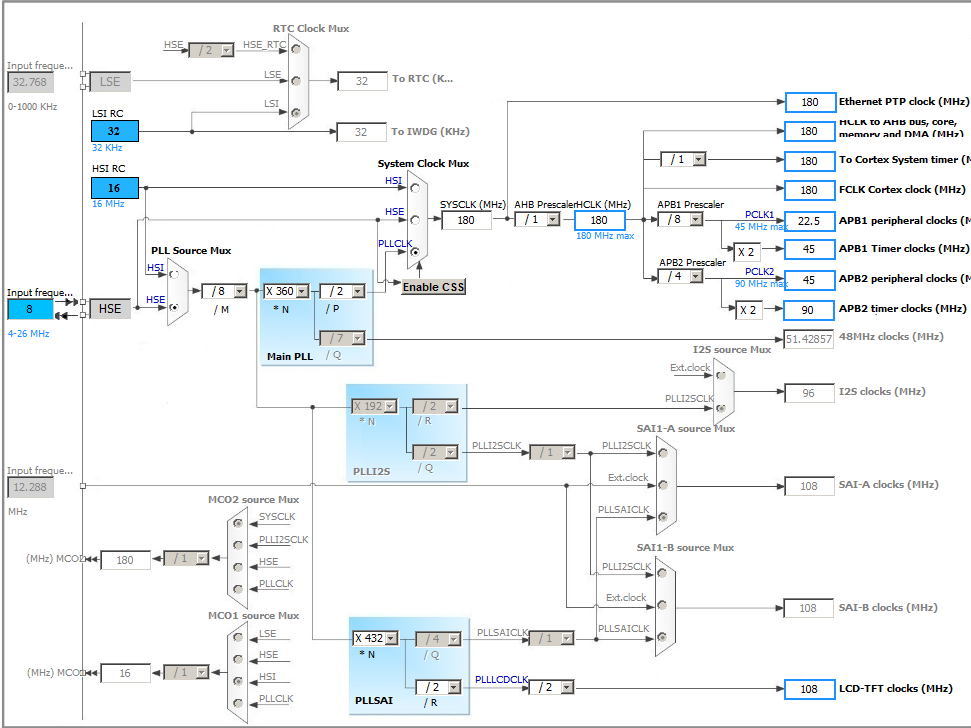

I have such clock settings (8Mhz at input runs to HSE, PLLCLK is used for SysClock):

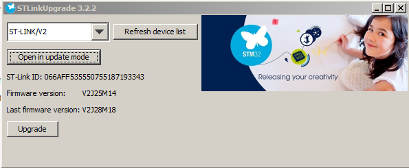

I have checked forum somewhat more deep, and found that the common advice here is to use this software. (Not sure what it does...)
I don't have any more ideas (removing resistors from board is too risky for me), so here it goes:

Yes, the V2J25 definitely falls into the window of one that misbehaves, the DISC1 was shipped in the thousands of units to Mouser and DigiKey, etc . Stocks might be quite old, and so generally whenever I get DISCO and NUCLEO boards which are not new releases I pull them to current firmware to avoid fighting old demons
The ST-LINK Utilities also ship with an update and drivers, but the stand-alone works well too, some times the releases on the website are not always in sync.
The 5V pin on the header should represent a good 5V_EXT injection point without any mods, based on my scan of the schematic. Like I said I use the Mini USB connector, as wall-wart supplies/chargers, battery packs and car chargers have high availability, and can typically supply 1-2A, which can open doors to higher power peripherals like Cellular modems to run using their own regulators off the 5V rail.

I was having the same issue and the firmware upgrade fixed the problem with the board.
