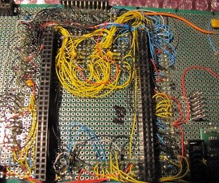

It's not a good board for prototyping. The LCD+SDRAM soak up a lot of the pins. You should review the User Manual, and go over the pins/resources you think you need. Think about how many pins you actually need to get over to the bread board, or use wire-wrap techniques. Better yet find an STM32 based ''break-out'' board where you can actually get to signals you can use.
The has an Arduino shield connector, and there are .2016-01-15 1:42 PM
No, You mustn't use breadboard. You can use female to male jumper wires.
