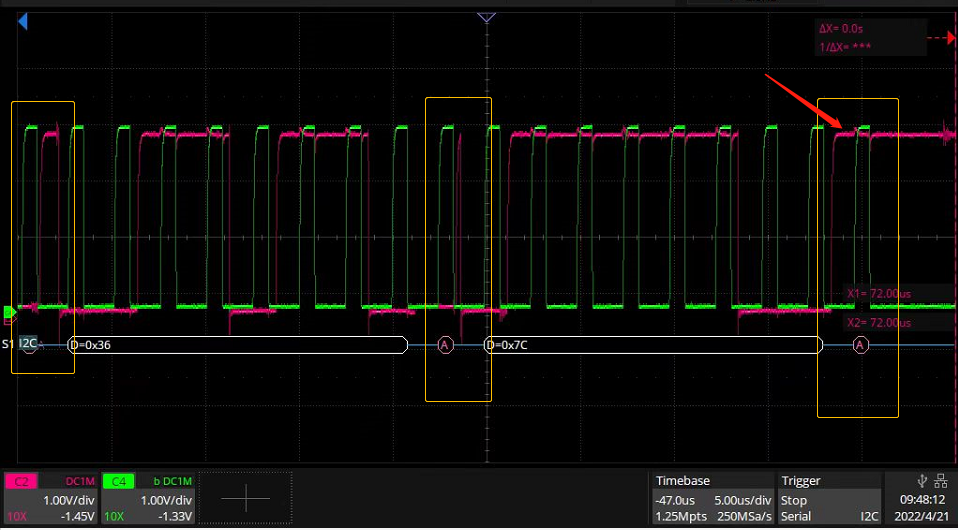

both SCL SDA are pullup by 1.5Kohm resister to 3.3V. I attached my I2C captures , it seems receiving no ACK bit from slave device after master device sending 0x7C. isn't it?0693W00000LyXsjQAF.png
Are all those from the same slave?
The two first ACK seems good, but there's no response from 0x7C, are you sending one too many bytes to the slave?
Double check the slave's datasheet to make sure you are sending the correct data​
yes, those are sending to one slave. the slave address is before 0x36,I send 0x36,0x7C, then sending another two bytes according to slave device datasheet.
it should be there's no response from SLAVE devce since 0x7C? I agree with this, but the the slave supplier disagree this and they think it's STM32F429's bug even though they couldn't point out where is bug.

The default is for i2c commands to reply with ACK after each byte. So there should be one after 0x7C, unless the slave manufacturer specifies otherwise. Do you have problems trying other commands to the slave? If you do you need to check your wiring/master i2c configuration.
I see on your capture that there's something on the line before. Does the slave asks for a repeated start before a new command? Are you generating such on the master?
Do your think 1.5k is too much so that slave cannot set ACK bit ? the capture shows there is one ACK bit set by slave after master sending 0x36, so may be the resistance is OK.
where can you see there are repeated start ? I just send command 0x367c.
