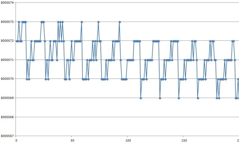

Hi! I try to measure GPS PPS (pulse per second) duration by TIM2. Setting code:
TIM_TimeBaseInitTypeDef TimeBaseInitStruct;
TIM_ICInitTypeDef ICInitStruct;
TimeBaseInitStruct.TIM_Prescaler = 0;
TimeBaseInitStruct.TIM_ClockDivision = TIM_CKD_DIV1;
TimeBaseInitStruct.TIM_CounterMode = TIM_CounterMode_Up;
TimeBaseInitStruct.TIM_Period = 0xFFFFFFFF;
TimeBaseInitStruct.TIM_RepetitionCounter = 0;
TIM_TimeBaseInit(PPS_IN_TIM, &TimeBaseInitStruct);
TIM_SelectInputTrigger(PPS_IN_TIM, TIM_TS_TI1FP1);
TIM_SelectMasterSlaveMode(PPS_IN_TIM, TIM_MasterSlaveMode_Enable);
TIM_SelectSlaveMode(PPS_IN_TIM, TIM_SlaveMode_Reset);
ICInitStruct.TIM_Channel = TIM_Channel_1;
ICInitStruct.TIM_ICPolarity = TIM_ICPolarity_Rising;
ICInitStruct.TIM_ICSelection = TIM_ICSelection_DirectTI;
ICInitStruct.TIM_ICPrescaler = TIM_ICPSC_DIV1;
ICInitStruct.TIM_ICFilter = 0;
TIM_ICInit(PPS_IN_TIM, &ICInitStruct); TIM2 clk:180Mhz. In interrupt value of CCR1 stored in array. Result:

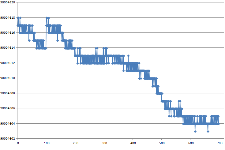

Reviewing the number of seen satellites and quality of reception might be helpful. The accuracy of the PPS will surely degrade with fewer satellites.
Technically you only need one to understand the performance of the local clock (TCXO, crystal, or whatever). Even a relatively mediocre GPS receiver design can keep a 1PPS signal within a 100ns rms.Where one might expect the saw-tooth is the placement ability of the receiver, ie the granularity on the clock (10MHz 100ns), and it's drift, so it walks off, and periodically gets slewed back via one, or half a clock cycle of the internal synchronous machine.In specialized timing receivers, where you can discipline the local clock, you can pull the drift to zero effectively, and you have a time source down in the ppb range.2016-04-22 3:22 AM
