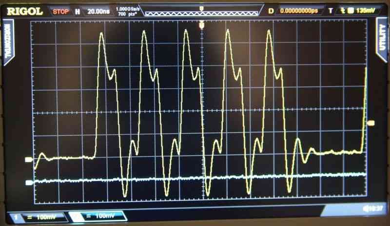

At micro level I am doing fast pulses that should be around 10 nanosecond long, but are 35 nanosecond long as shown in oscilloscope.

Assembly code for the while(1) loop
080002FE strh r3, [r2, #24]
08000300 strh r3, [r2, #26]
08000302 strh r3, [r2, #24]
08000304 strh r3, [r2, #26]
08000306 strh r3, [r2, #24]
08000308 strh r3, [r2, #26]
0800030A strh r3, [r2, #24]
0800030C strh r3, [r2, #26]
0800030E strh r3, [r2, #24]
08000310 strh r3, [r2, #26]
08000312 b.n 0x80002fe <
main
+50>

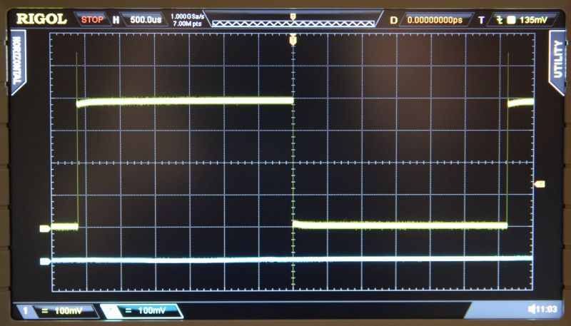

At macro level, I am trying to toggle a pulse with 1000 Hz frequency. The expected pulse width is 1000 microseconds, but oscilloscope shows 3222 microsecond long pulses.

The assembly code for the infinite loop is
08000320 ldr r3, [r1, #4]
08000322 cmp r2, r3
08000324 bcs.n 0x8000320 <
main
+84>
08000326 adds r0, #1
08000328 lsls r3, r0, #31
0800032A add.w r2, r2, #179200 ; 0x2bc00
0800032E add.w r2, r2, #800 ; 0x320
08000332 ite mi
08000334 strhmi r4, [r5, #24]
08000336 strhpl r4, [r5, #26]
08000338 b.n 0x8000320 <
main
+84>
Note how the 1 millisecond value (180,000) is implemented as 179,200 + 800.
