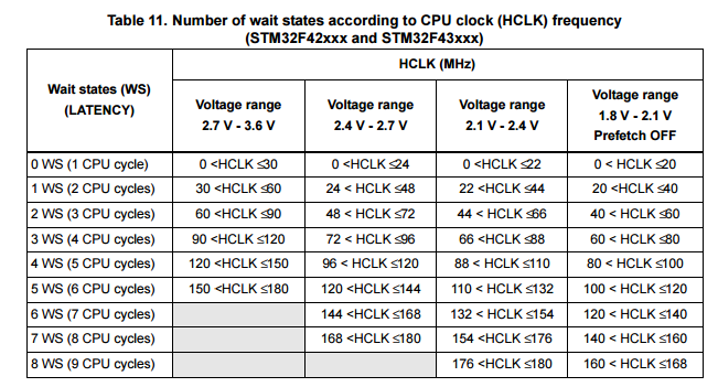

The VOS and Over-drive bits in PWR->CR might play a role, and how aggressively the flash wait states are, 5 or 6 being the most common .
