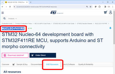

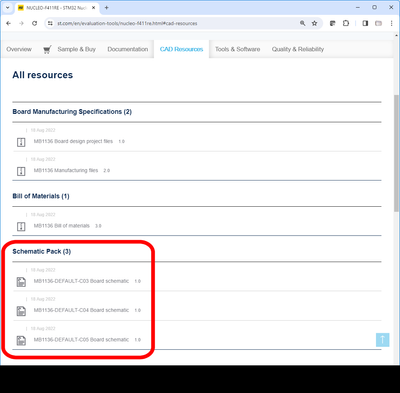

As @gbm said, "STM32F411RE" is a microcontroller - not a board.
If you have an ST board, the schematics will be available on its Product Page; eg, for the NUCLEO-F411RE board:
https://www.st.com/en/evaluation-tools/nucleo-f411re.html
Look on the 'CAD Resources' tab:
https://www.st.com/en/evaluation-tools/nucleo-f411re.html#cad-resources
Schematics are usually also included in the User Manual - see the 'Documentation' tab.
