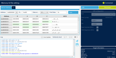

Hello, i am trying to use system bootloader in STM32F411 for software update via USB. I use a freertos in my project.
Workflow is here: By sending a "BOOT" via Virtual Com Port USB, MCU executes folowing code:
and succesfully jumps into embedded bootloader, so I can read an mcu software with usb in dfu mode
but I can't update a software using "Erasing and programming" tab and get errors "LIBUSB_NO_DEVICE" after erasing of previous software

2024-08-24 4:14 AM
Dear @butaforsky ,
is that possible to run the USB DFU system bootloader after a power off and power on while forcing the Boot pins by hardware and see if you have the same behavior ?
The goal is to check if the behavior is linked from the FreeRTOS application dynamic jump to system bootloader : such as using shared ressources like RAM or corrupting some buffers causing such issue .
let us know
