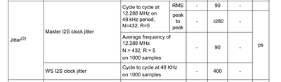

2023-09-07 10:05 AM - edited 2023-09-07 10:14 AM
use crystal as clock - if possible (max. 50MHz using external oscillator );
if needing pll , crystal source... better not possible in this case.
but from data -- jitter not sooo bad here , F411 :
or try other chip , i use H743 and here pll seem better...
or (as i did) with DAC, set DAC as I2S master with his own oscillator, optimum performance.
