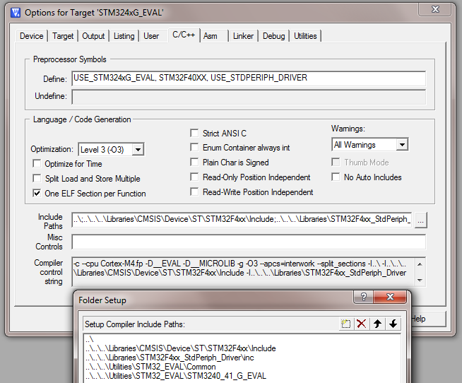

Yeah, your not defining a BOARD that's supported, look at the #ifdef stuff above the failing line.
USE_STM324xG_EVAL, STM32F40XX, USE_STDPERIPH_DRIVER

Posted on April 15, 2013 at 18:48
Ok, so you haven't correctly defined all the Include paths needed for the project (-I command line option list). You need to point into the Utilities directories containing the files the compiler needs to find.
STM32F4xx_DSP_StdPeriph_Lib_V1.1.0\Utilities\STM32_EVAL\STM3240_41_G_EVAL

Posted on April 15, 2013 at 19:10
You can also control the Include path search order, here is how the projects expect things to be defined. Adapt as appropriate.
