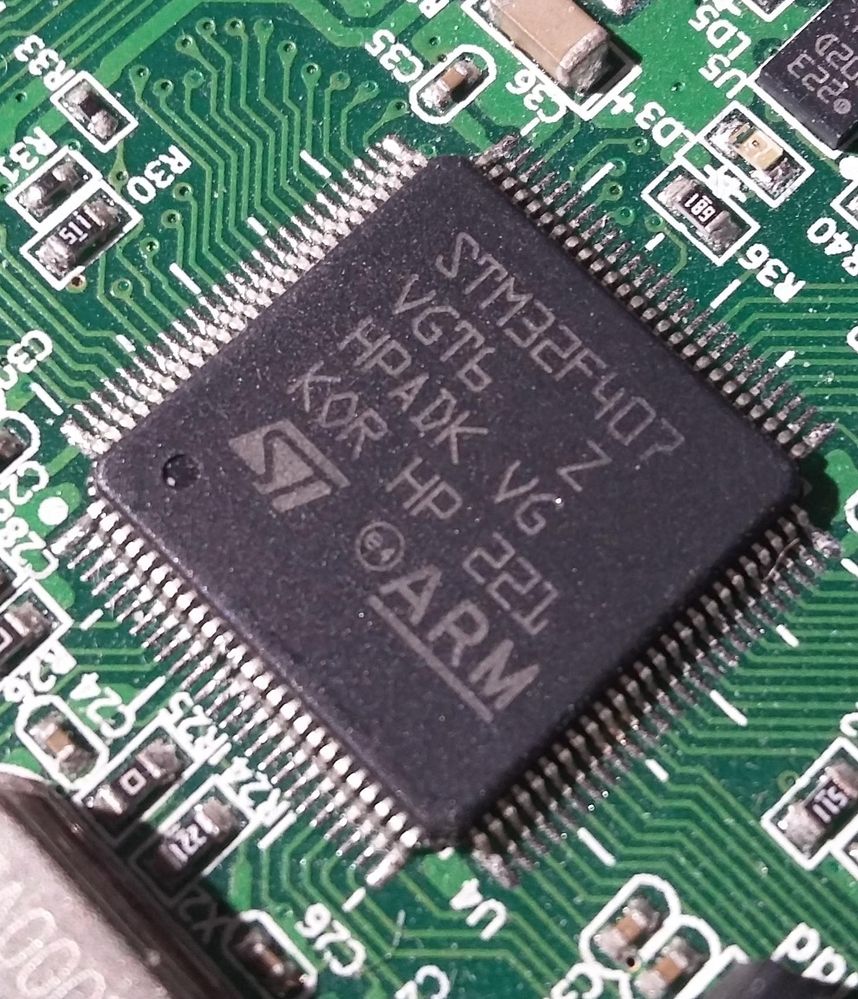

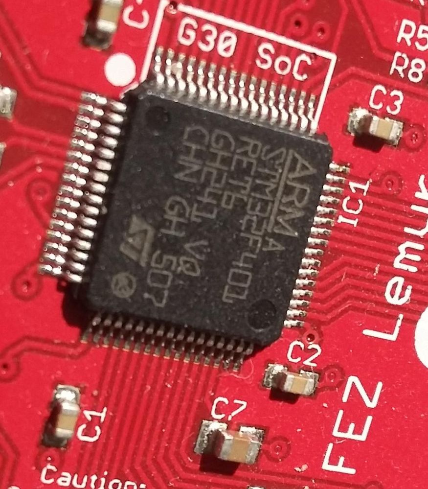

While the text is certainly a big cue, you definitely have parts where the pin 1 is less than crystal clear
Note also the round, some what indistinct round laser mark next to the ST Logo, these aren't helpful to the casual inspection

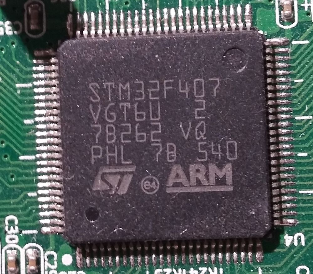

Ok, and here is the part that breaks the manual, and the one I looked at last night when responding to Andrei's question, the other F407-DISCO boards I looked at this morning lacked the ejector. As a casual observer you can see why this could be place 180 from desired.
So that's one packaged in the Philippines,
Here's one from Korea, which is orders of magnitude clearer
Apologies for all the different image orientations/angles, doing this with my cell phone, trying to get the lighting to capture the surface details, and stay in focus.

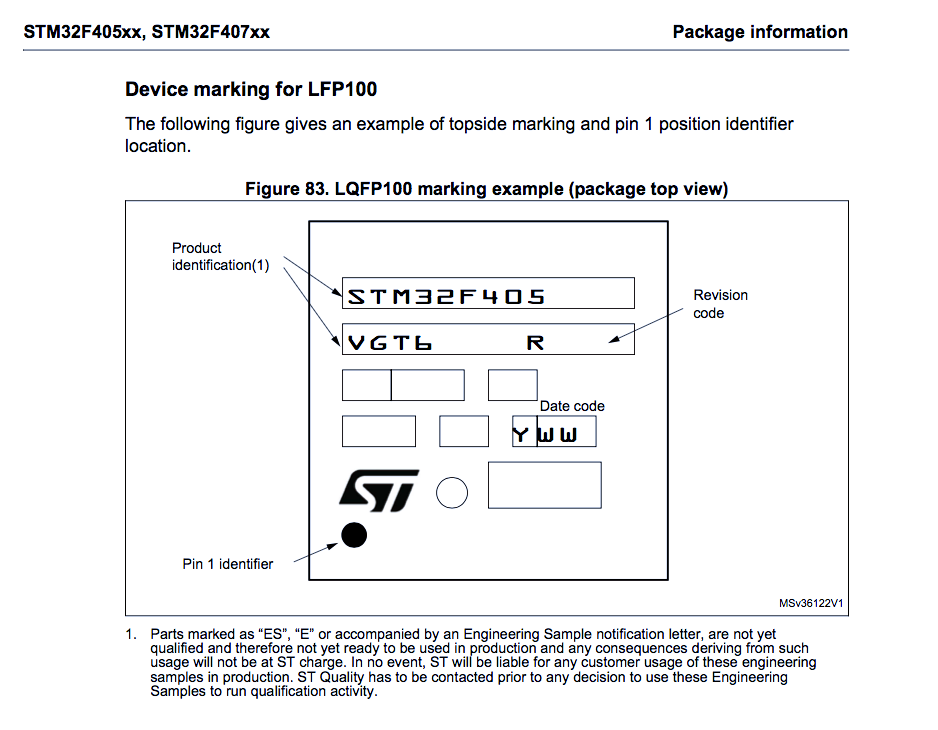

That's unpossible Clive, here is the '407 LQFP100 manual package description.
There's no mention of the ejector pin details that you show in your pictures.  (troll lol lol lol oooo)

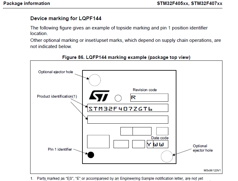

On the current STM32F407 Data Sheet    DocID022152 Rev 8       09-Sep-2016   it says above that diagram, 'The following figure gives an example of topside marking and pin 1 position identifier location. Other optional marking or inset/upset marks, which depend on supply chain operations, are not indicated below.'
On this maybe, give them a break?
