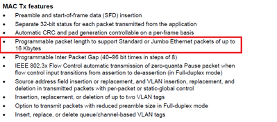

Unfortunately STM32F407 MCU does not support Jumbo frames (16kB).
STM32H743 MCU does support Jambo frames. From RM0433 rev 8 page 2779:
