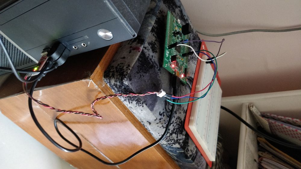

It worked after connecting TTL to USB connector from USART2 and selecting the com port in a manual mode.
