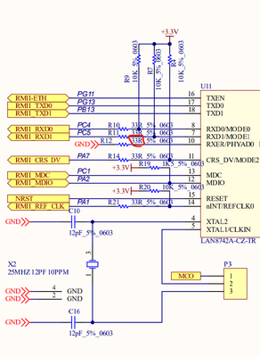

I have created Ethernet custom board using STM32F407 + LAN8742A attached is my schematic design based on Nucleo board for STM32F429ZI.

Also check my PCB file to verify the placement and routing and suggest the changes if there are any files attached.

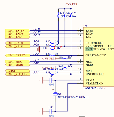

also, after a quick check of your design I find that it is not compliant with the schematic of the Nucleo F429 which embedded the same PHY.
the RXFER/PHYAD0 pin has 33-ohm resistor and in our schematic, we have a 10K resistor:
Nucleo schematic

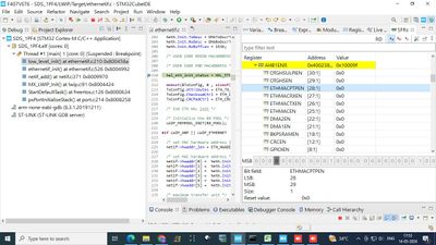

2. checked ETHMACxxEN bits in RCC_AHB1ENR are set or not
Before calling HAL_ETH_Init()
after calling HAL_ETH_Init()

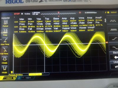

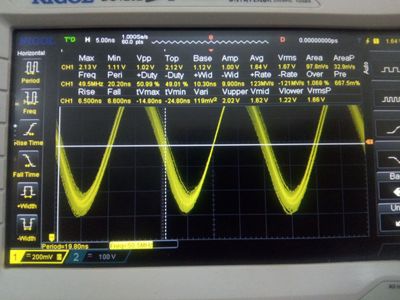

Changed the Resistor value for RXFER/PHYAD0 pin to 10K but issue is still same. on nucleo board after successful init I can observer 50MHz clock on Refclk0 pin but in case of custom board is not observed.
Following is the Clock signal observed for LAN chips on custom board with same of capacitor value (30pf) similar to nucleo board.

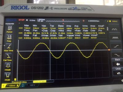

with similar part number for oscillator for LAN as nucleo board following is observed on nucleo board

2024-07-05 4:35 AM
Hello @VivekBorse ,
The clock on your costume board seems to be quite noisy I don't know the reason behind this, but I think it is related to your PCB layout, spacing ,routing ,isolation ...
if you have any updates on this it will be great to if you have succeeded in making your costume board working.
Regards
