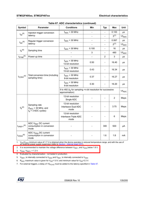

In the STM32F407 DS, ADC characteristics table has the following footnotes:
IMO 2. follows from 3. (which is a more stringent requirement); thus 2. is redundant and confusing.
2025-06-17 3:14 AM
Note 2, is related to the power-up phase while note 3 is related to the functional mode when the ADC is running.
So note 2 will be updated to mention that difference.
The proposed change:
2. When VDDA and VREF+ are supplied by independent voltage sources, during power-up phase, it is recommended to maintain the difference between VDDA and VREF+ below 1.8V.

2025-06-17 3:14 AM
2025-06-17 11:03 PM
Thanks for the clarification.
