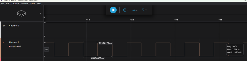

Hi all, I tried to configure the clock to run at 32MHz and I was using Systick to toggle the LED every 1 Sec by configuring the Systick reload value by 32Mhz -1. But, Somehow toggling is not happening for exactly 1 sec, and also used a logic analyzer to check the period and it was not 1 sec. Somehow, I am not able to figure out the problem.
I selected HSE(8MHz) and PLL as a System clock. PLLM = 2,PLLN=16,PLLP=2. AHB prescaler as 1.
